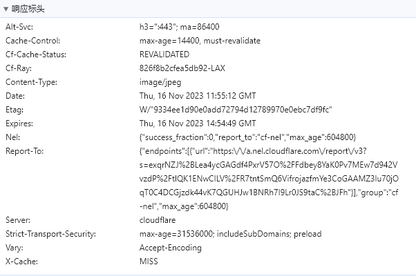

开启CDN访问图片正常显示,然后我源站删掉图片,再刷新就404了,这压根没有缓存啊,但是我看返回头也有缓存时间
理论上来说,删掉源图片,CDN应该还在缓存有效期内啊,除非清除缓存

如果是显示Cf-Cache-Status: HIT就是命中了吧

Cache control header 是 must-revalidate
The must-revalidate directive is used to tell a cache that it must first revalidate an asset with the origin after it becomes stale.
